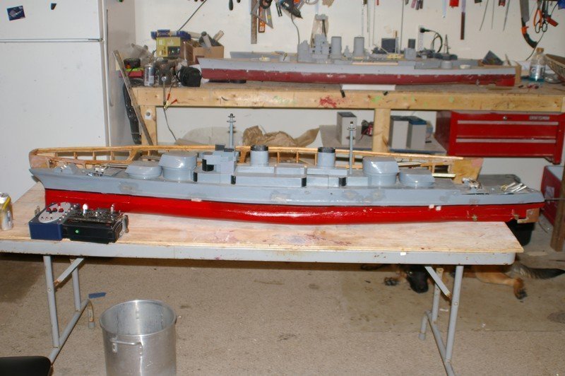

    Tom Z. has given us the go-ahead to make the conversion of his big-gun battlecruiser USS United States into a Treaty boat,
    so that we can get the old girl back into service in the near future.
    The project will be made up of two parts.
    In part 1 we will be taking the existing hull and superstructure, and installing a set of Treaty format internals into her.
    This part of the project was kicked-off today at the build-session in Miamisburg. Ohio.
    We are not entirely certain that we can get her ready for the up-coming Treaty battle in Versailles, Ohio in two weeks.
    But we hope to at least have her ready for sea-trials by that event.
    We do feel fairly certain that the ship will be combat-ready for our event coming up on the July 4th weekend.
    We have invited Tom to come down and take his old ship in harm's way again with us.
    Part 2 of this conversion will consist of building a brand new Battlestations boat around the big-gun main cannons, and torpedo tubes.
    The ship has 4 main turrets (quarter inch twins), and eight torpedo tubes.
    This part of the project is in the planning stages. But we hope to have up-dates in the near future.
    We will start another thread on this part of the project.
    Tom and his grand old battlecruiser were staples of the old Midwest Battle Group back in the day.
    And it would be great to see both Tom, and the United States back in action again.
    We will keep you all posted.

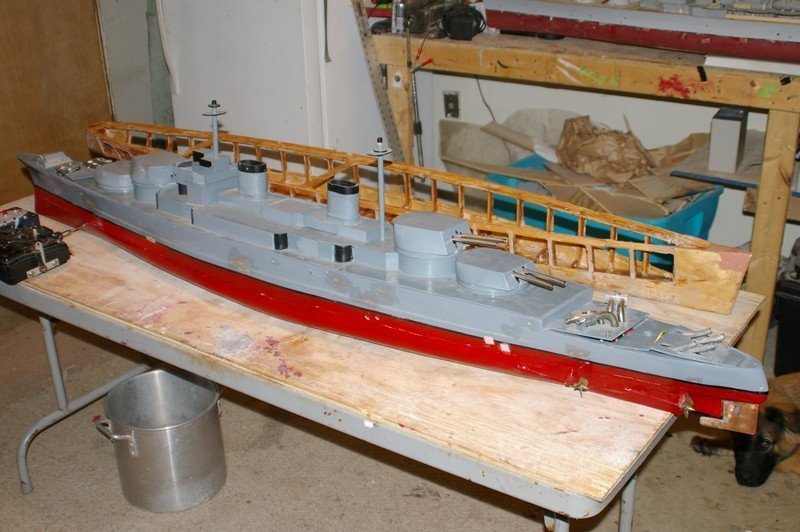

    Nice to see another Lex out there. She really is a beast. 8-16" 14-6" w/ 8 tubes. How does she handle?. Any pitfalls you found working this particular hull? Mines is about 35% hull comp. Gotchas would be great.
  14. glaizilla
    glaizilla Active Member
    Sep 24, 2010
    375
