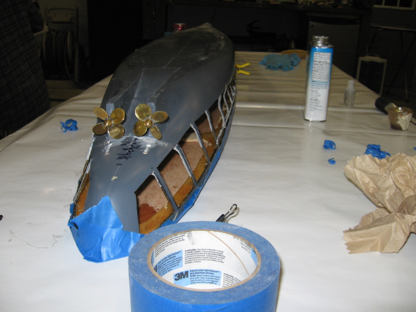

    Big, smeggin' brutal 4-blade props! She should have great acceleration
    forward AND reverse.

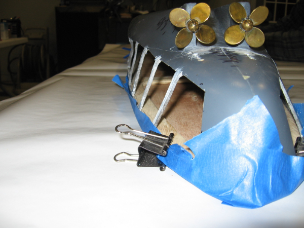

  3. djranier
    FYI
    I would look at reversing the props so that the props spin in at the top and not out, with the testing that we have done at Rick's, odds are you will get some prop cavatation the way they are installed now, which will slow the ship down.

    Yeah, thats what rob said. I'm gonna set them up that way.

  6. rarena
    That was the discussion we had and I agree with you on that one. We were going to do it that way and low and behold, they are reversed! Don, flip those when you get the chance.

    Good point. I just noticed they're backwards.

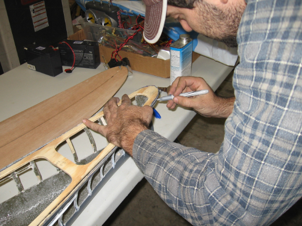

    Quick question Rob. How do I find where the holes in the subdeck are from the top? So that I can make the deck cutouts a little larger? Bow that the deck is permanently attached.
  12. rarena
    First things first. Locate your gun turrets and the basic superstructure on the deck. Forget about the subdeck. You cannot locate the holes and come down on it. Besides it is not really enough to carry all your panels. Plan where the cutouts will be. Make sure you don't cut through a subdeck crossbrace. Then cut holes out and reinforce around the holes with other wood glued/epoxied in. Let me know if this doesn't make sense to you. I will try to explain it better.

    So lay my plans over the deck and mark where everything is. Then take cutouts of superstructure and turrets and lay them on place.
  14. rarena
    Yep, draw everything out on your deck. No sense having a cutout in the middle of something you need.Then flip it over and find the subdeck. The holes will probably be where there is no subdeck. That is what you want. Cut your pop out decks remembering to leave enough room to move what you need inside the space (batteries, co 2, ect) This will be the only way you can get in your boat so make these count.

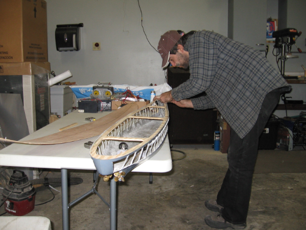

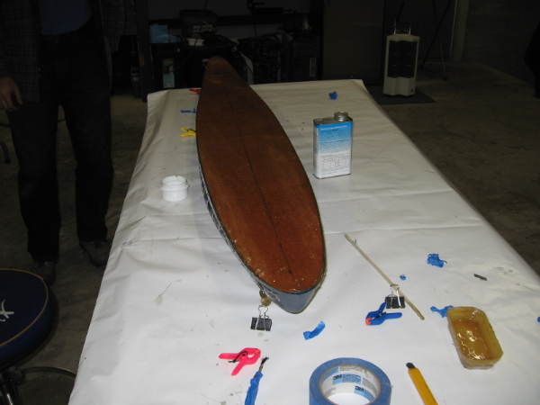

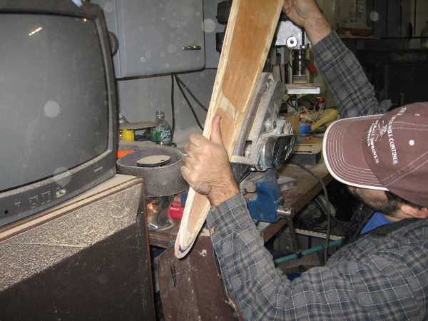

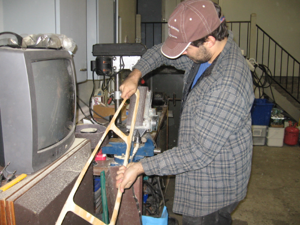

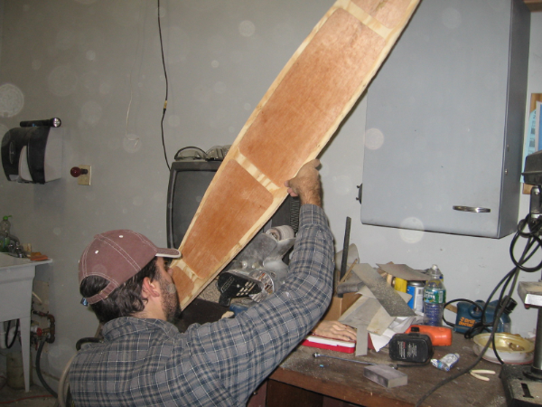

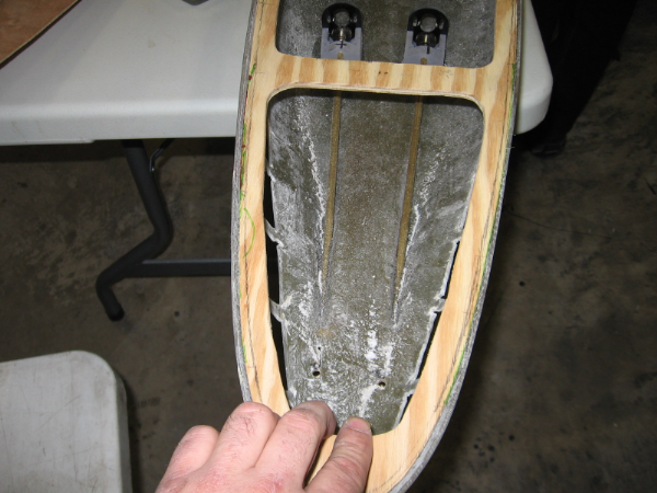

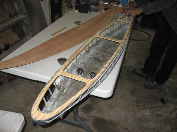

  16. rarena
    No Notebook but here's a ship!!!!!!!!!!!!!
    These are picts of Donanton sanding the subdeck to fit the hull, attaching the deck and gluing it all together!

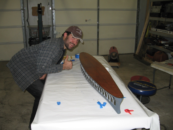

  17. donanton
    donanton Member
    Aug 31, 2007
    408
    Yes the boat does exist. I give it 1 thumb up.
    Notice the fine mohagony decking.
