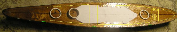

    Got some pics here
    The green lines mark where the cross braces are in the subdeck.
    The turrets and superstructure shape are in place.
    The line 1" inside the hll is the 1" Rob told me to stay from the outside when cutting holes.

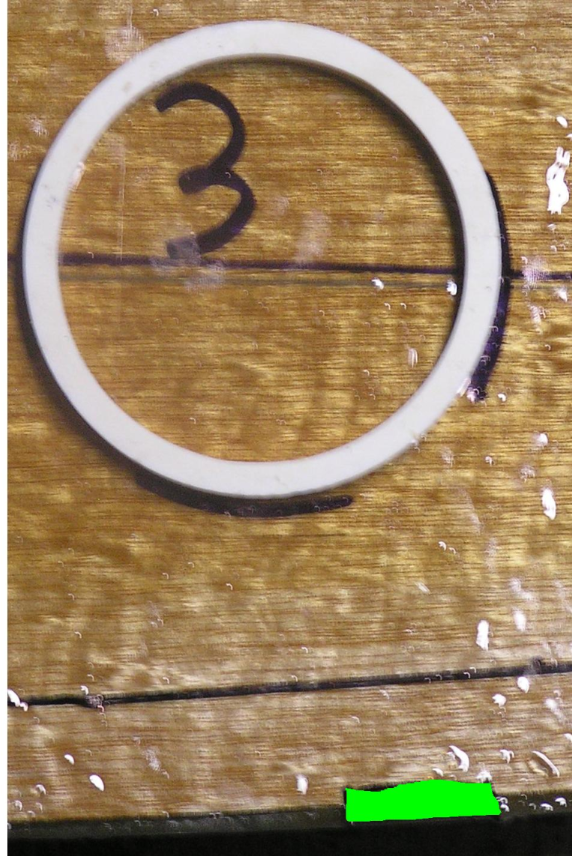

    Heres a close up of turret 3 and the nearby cross member.
    I now have to cut the top deck without cutting the subdeck under the superstructure and the 3rd cross member by the rear turret to figure out.

    With my Konig hull I am building I actually trimmed one of the cross members for a coil cannon I am installing. What I did do is reinforce the cross area then with a bit more wood and a small 1/4 aluminum rod to add some strength back to the cross member.
    That ship is looking good so far. hope to see it someday in person if I am lucky.
  10. rarena
    My guess is "what do I do with the third crossmember?" Cut through it and we'll put another in somewhere past it. Probably between that hatch and where your rudder access hatch will be.

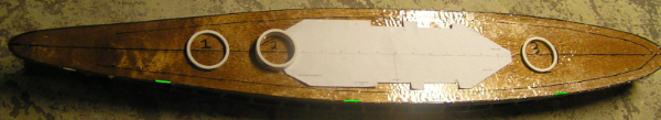

    Here's wherer i think the cutouts should be.
  12. rarena
    That looks pretty good to me. It's where I would cut. You can even run the fill tubes for the guns under the stupidstructure.
