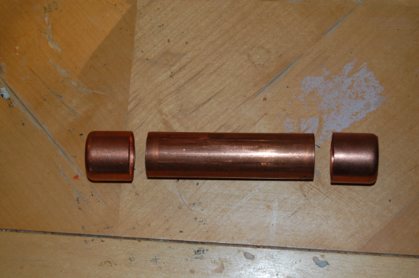

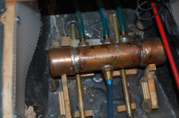

    Anthony... if you haven't built an expansion tank yet, you will find they are easy and fun to make. In my Washington, I have one in the stern for the triples which work great!
    Go to Home Depot or Lowes and pick up a four inch piece of usually pre-cut copper piping and two one inch end caps. You can slide the end caps in and out to adjust the length for installation in your boat. Then drill three small holes in one side of the expansion tank which will receive the three 1/8th inch hose nipple.
    On the other side, drill one hole which will take another 1/8 hose nipple. Prepare the copper parts for soldering and solder the four nipple in the holes. Then solder the two end caps together and that's it.
    The single nipple will fit into the 1/8th air hose from the CO2 bottle, that fills the tank and the three exit nipples fit into the 1/8th hoses that go to the solinoids. There is plenty of air and always a supply for the triples.
    That's how I did mine and it works great. I am sure there are other ways, but this seemed to be the easiset for me.

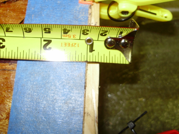

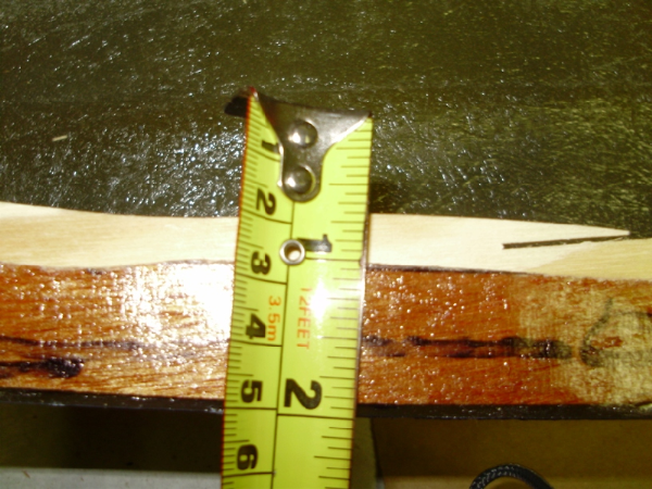

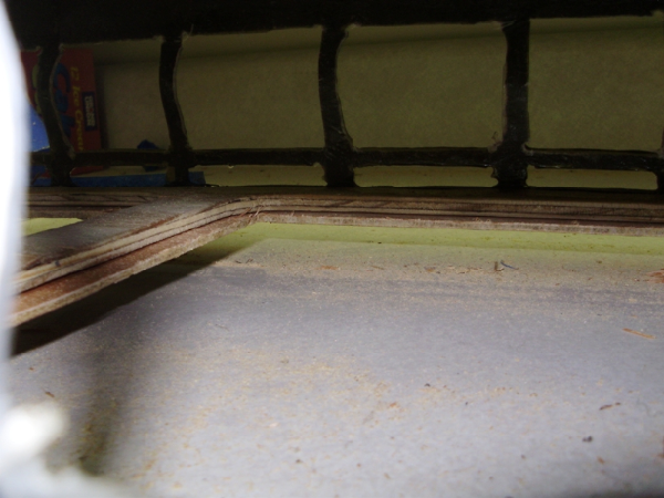

    I cut the deckholes out and I realized I should have cut 11.5" in from the sides. I have about 1/4" deck past the subdeck. So glue a strip under the subdeck as extra support?
  10. rarena
    I'm guessing you cut into the subdeck as well. Just build it up like you were going to for the pop panels. 1/4 shouldn't weaken the subdeck anyway. You could run a piece of 1/4 by 1/2 all the way down right up against the subdeck leaving you a lip to set your top deck on. Glue it underneath the top deck that remains past your panels.
  11. donanton
    donanton Member
    Aug 31, 2007
    408
    I have 1/4" of deck protruding past the sub deck. I was going to use the pre cut out scrap subdeck parts I got with the sub deck for reinforcing anyway.
  12. rarena
    That will do. Post some pictures, I would love to see how you are making out.
  13. donanton
    donanton Member
    Aug 31, 2007
    408

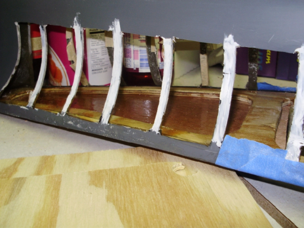

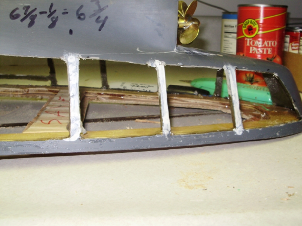

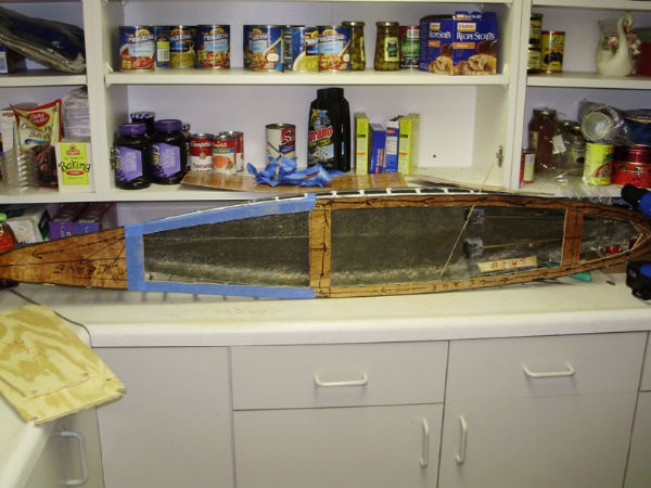

    Some pics of the deck hole cut out.
    The overhang of the main deck past the subdeck.
    Front hole Left covered.
    Subdeck overhang with added bracing.
