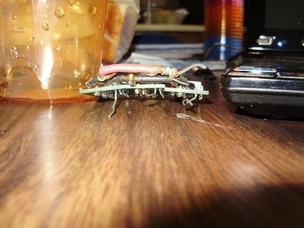

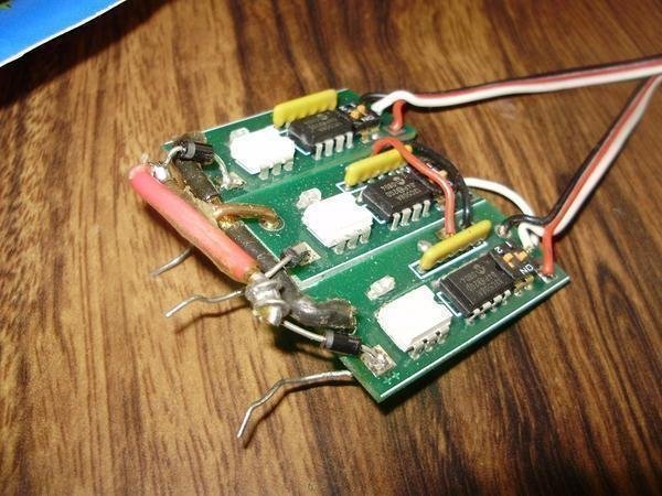

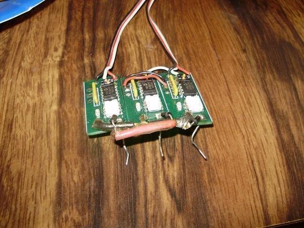

    I've got pics of my delta board setup. I'm in a quandry on how they attach to the solenoids themselves.
  11. rarena
    Thick black wire where three come together This gets hooked to negative of battery (6v)
    Thick red wire with three diodes attached hook this to positive of battery (6v) and all solenoid red leads
    Black from each solenoid goes to the silver leads hanging out the bottom. This is the delta board trigger lead, for the triples hook three blacks to one.

    and the 6v booster pack goes between the delta boards and the main battery, right?
  13. jadfer
    TD and all other board makers recommend strongly that you place the diode as close to the coil (solenoid) as possible. I put mine on the deans plug that is 4 inches from the solenoid.
  14. rarena
    6 voltbooster goes negative to plus side of battery, negative to red wire with three diodes. (making it a 12 volt battery or use one)
    I was unaware of the closeness rule but it makes sense. I have operated mine like this for years but it still makes sense. In order to get it any closer to the solenoids, you must cut the wires at the solenoids and solder diode across the negative and positive.
