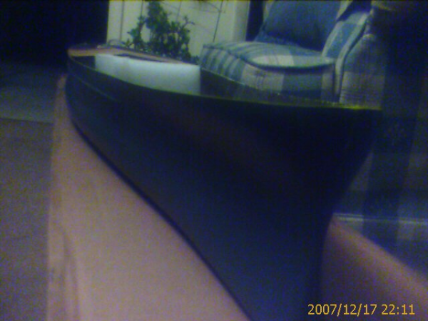

  10. donanton
    donanton Member
    Aug 31, 2007
    408
    Dam, this is a big boat. It's so big i cant put it under or behing my tree. I have to put it behind the couch. I'm no expert, but it looks great with it's knockles and torpedo bulges. THere are 2 propeller things sticking out of the bottom of the ship, not four. Is this ok since the outer 2 props wont be powered anyway?
  11. JasonC
    JasonC Active Member
    Jan 13, 2007
    184
    the NC back end looks alot like my new jersey where the 2 center props were on skegs and the outer 2 are on loose shafts with struts on them
