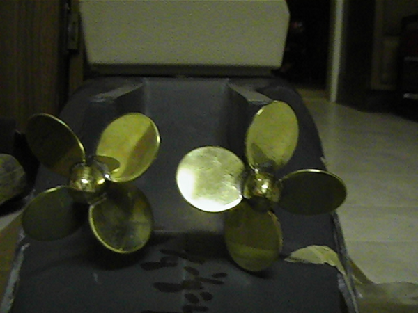

    Quick question. I drilled the skegs, test fit the stuffing tubes, and installed the props. I was suprised that the props barely cleared the hull by a few sheets of paper. On one of the props, all the blades clear except one. Any suggestions?
  5. SnipeHunter
    Sand down the hull where that blade hits.

    The grotescly tiny shaft clearance.

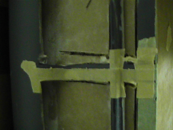

    And some pics of the tape job that will lead to making the ribs actually 1/4 inch ribs, not the slightly large size in the picture.
    Looks a little like a tape job of khorne to me.

    That propeller clearance looks fine, you want them to be close.

    TAPE FOR THE TAPE GOD! lol Don :) I was thinking Nurgle's tape demons came by...

    Actually, the shafts go down as they go towards the stern of the ship. Since the props are as close to the hull as possible (which im told is a good thing), Can I sand the bottom of the gearboxes so that the shafts are level?
    5-13-8
    Ok, im filing down the gearboxes since they''re the problem.

    I filed down the gearboxes so that the shafts are level, but now neither of the props have any blades hitting the hull. Shouldn't lowering the gearboxes raise the props? The props are within 1/16 of the hull anyway. Should the stuffing tubes be flush with the ends of the skegs when I glue the gearboxes down?
