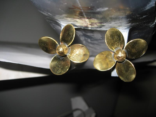

    Now that the hafts are level, the props hit the hull. Gotta lower the shafts and sand the gearboxes more.

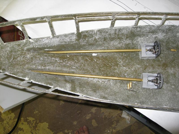

    Ok, the shafts are level and the props clear the hull barely. What bondo did you guys suggest to glue the gearboxes down? What about the epoxies from lowes/depot? Do they suck like everything else in the store or are they to be trusted since they are loctite?

    Do you have any pictures, (side view) of the shafts? What size props are you running?

    I don't know the size. They're from Battlers Connection. I'll try to get a side view this weekend.

    Someone requested pictures of the level shafts without the props hitting.

    Very clean job sir. That was me that asked about the pics.
