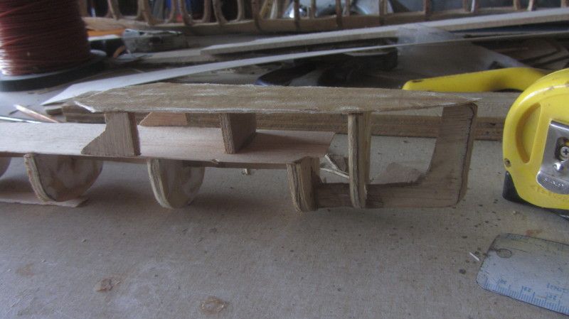

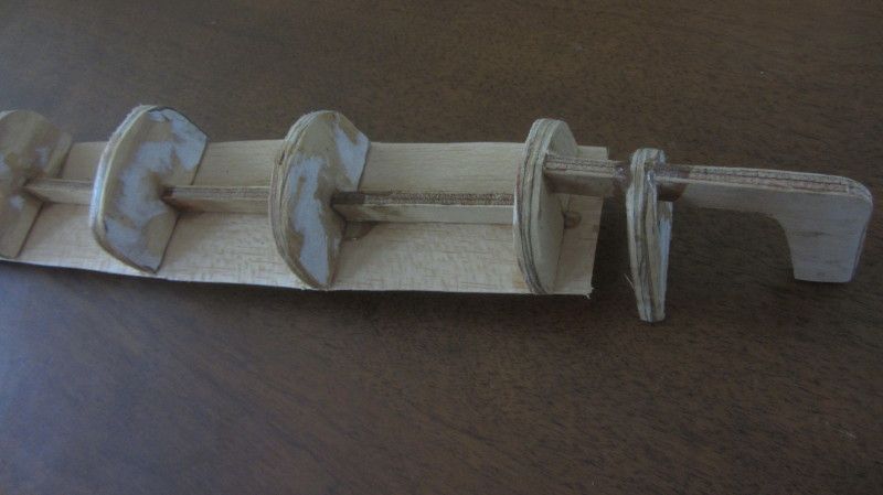

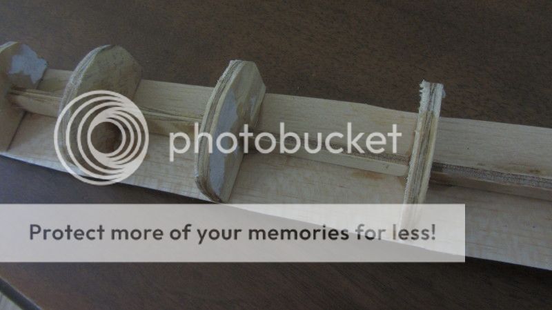

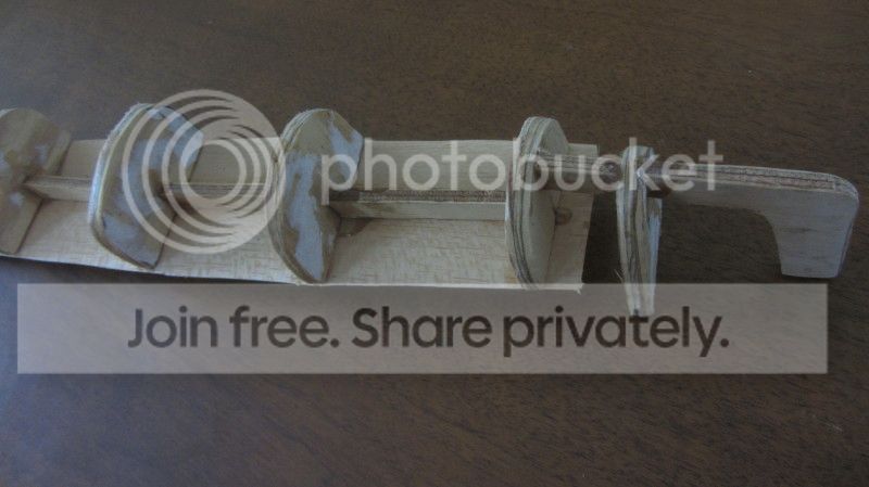

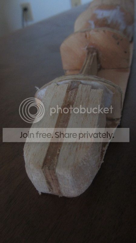

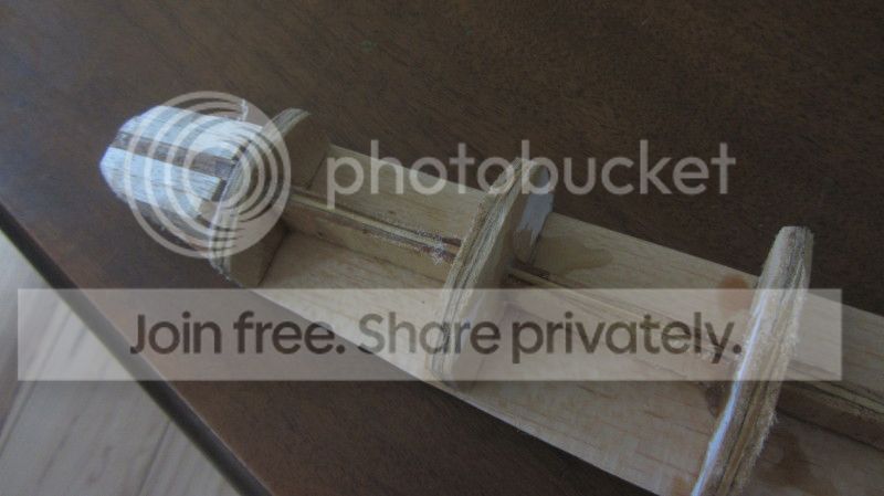

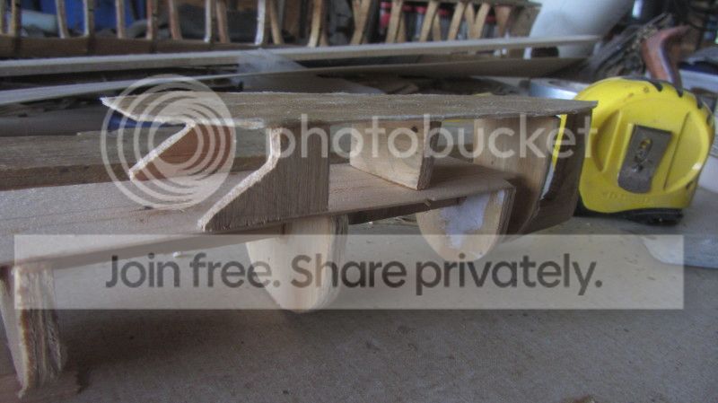

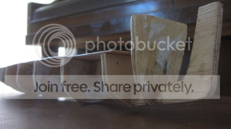

    I know I probably shouldn't be working on a second ship, but this was something for me to do while I wait for the parts for my Suffren to get here from Hong Kong.

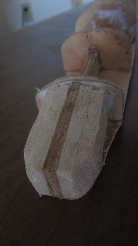

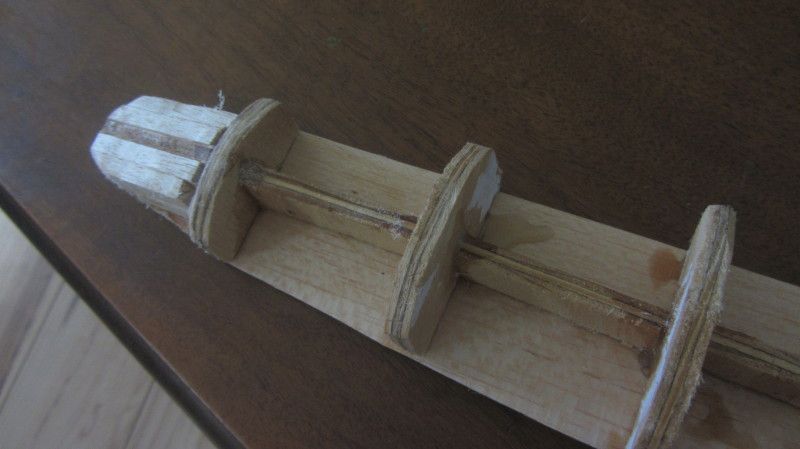

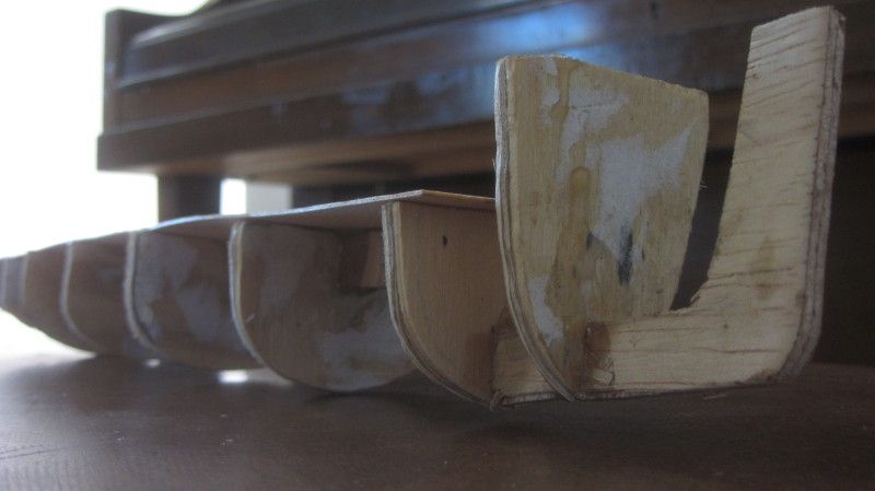

    I'm working on the plug at the moment. This is sort of a mix-match boat. I downloaded the hull templets that Tugboat put on here, and the rest is all guess work.
    So on with the pictures. ( I know you guys love lots of pics so I took a lot)
    This is just the plug, but I'm hoping that later I can sell the hulls for people that want one. ( just a thought of mine)
    The balsa on the top is just there for strength at the moment.
    The stern still need some more work to get the right shape, but that can wait for later.
    Enjoy, and if you see something that doesn't look right, let me know.
    Beaver

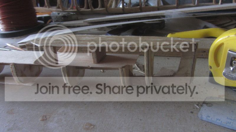

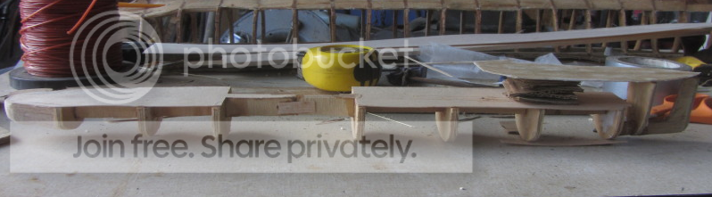

  14. Beaver
    RE: V-106 Build I have some questions on the front deck. How wide is it at its widest point? I thought that it would be as wide as the frames, but looking at this profile picture it seems that it's wider than that.
    So, what so I do, go by the plans, or by the frame width?
    I have that foam now, so as soon as I get this part done she'll be full of foam.
    Beaver
  15. Tugboat
    RE: V-106 Build Let me recheck the plans... But I think they're correct.
  16. Beaver
    RE: V-106 Build Thanks, Tugboat.
    I wasn't sure which to go by, because looking at other peoples' models, it looks like it's the same width as the frames.
    So, if it is wider, do I taper the hull outward to meet the deck?
    Beaver

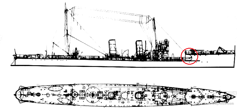

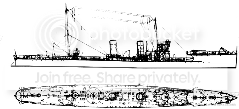

  17. Beaver

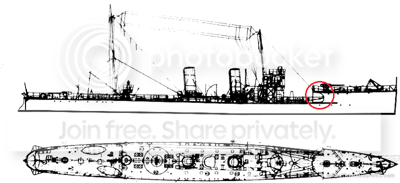

    RE: V-106 Build I got the top deck cut out, but have one more question. On this piece that is circled, what is it supposed to look like?
    I've seen it look two ways, but which is right #1, or #2?
    Beaver
  18. Anachronus
    RE: V-106 Build http://www.steelnavy.com/MirageV106GA.htm
  19. Beaver
    RE: V-106 Build
    Thanks, Anachronus! That helped a lot. So I guess it's neither of the two.:)

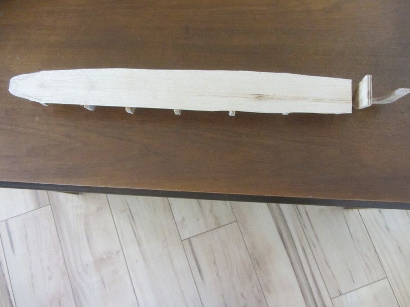

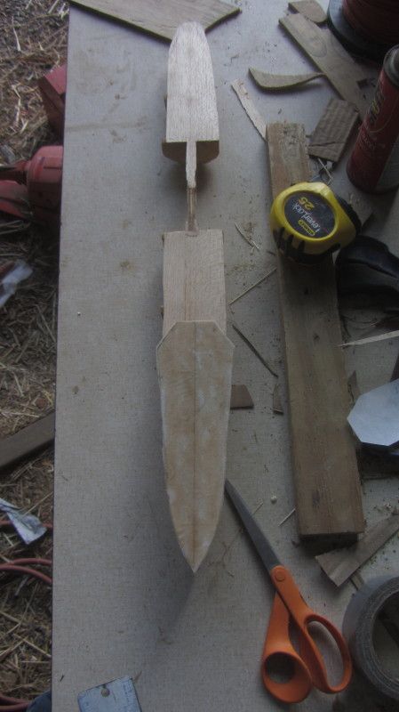

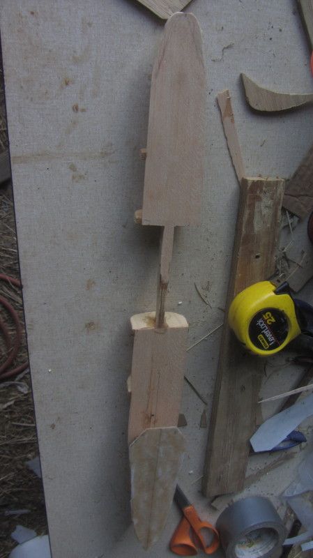

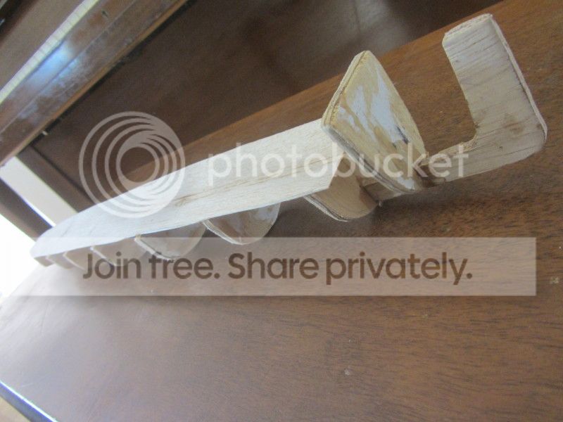

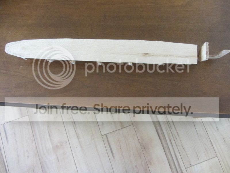

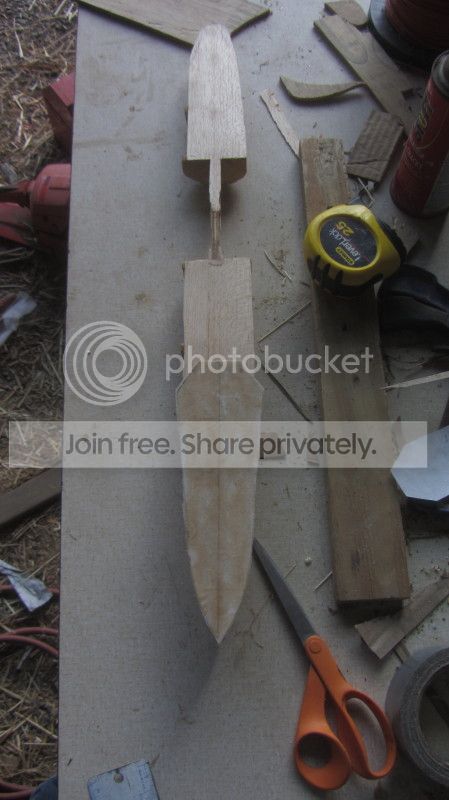

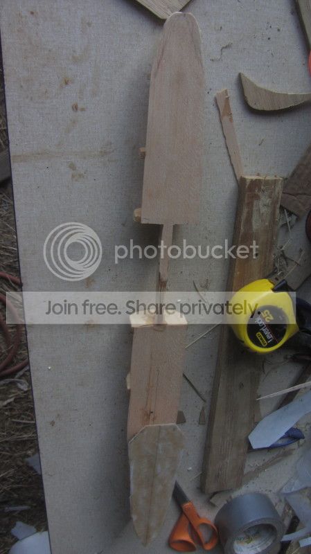

    I figured I'd upload some photographic proof that I was working on V-106 and not just saying I was.
    So here are the pictures of the new deck.
    Sorry about the image angle, I forgot to rotate it.
    Enjoy,
    Beaver

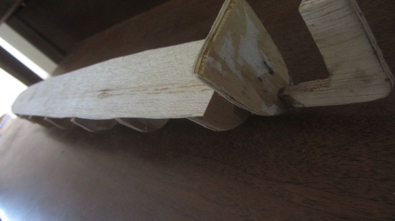

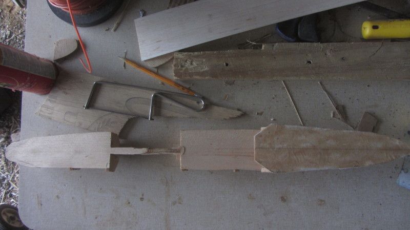

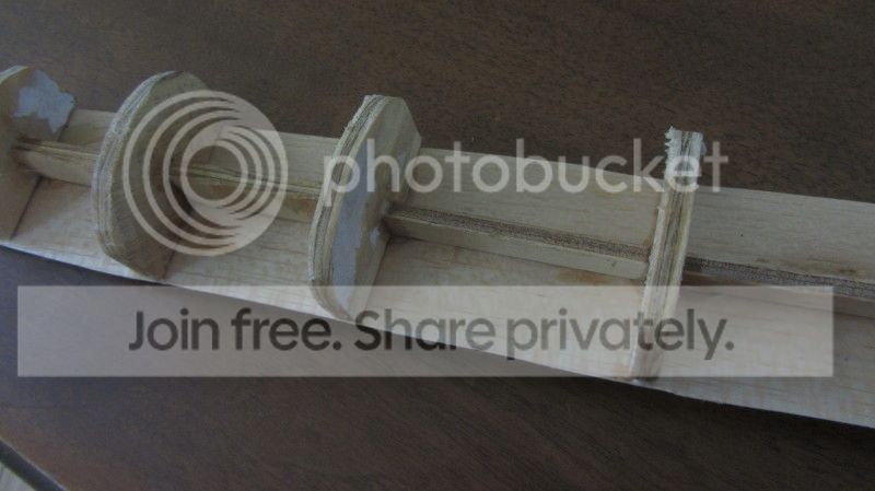

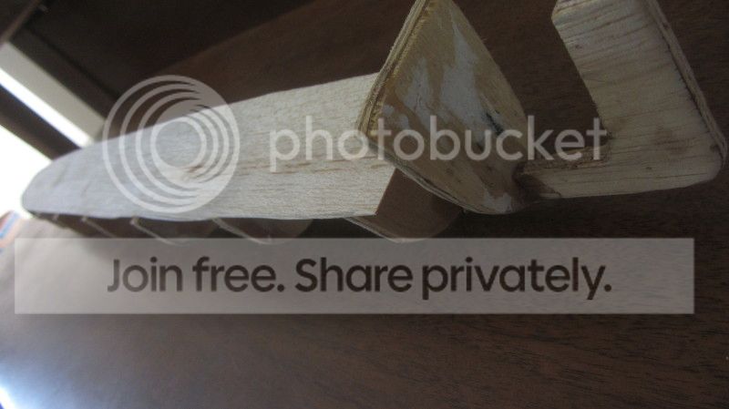

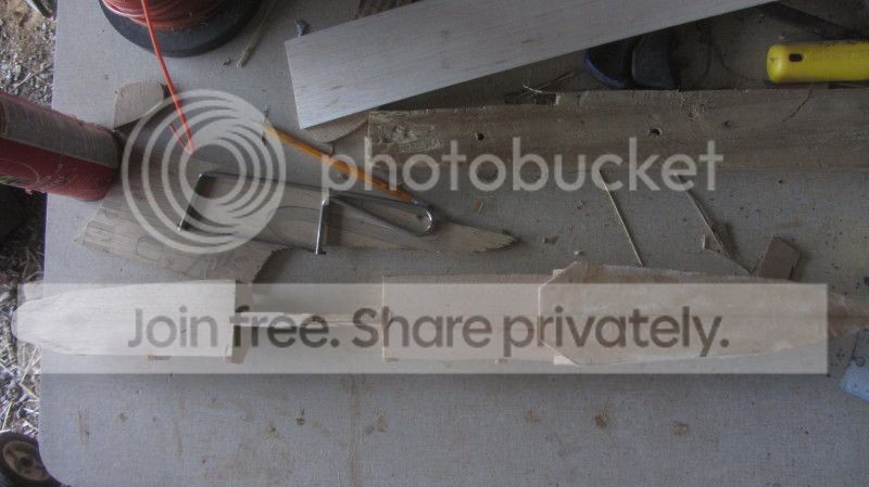

  20. Beaver

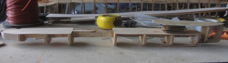

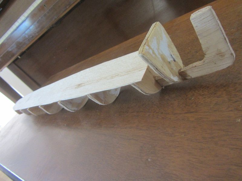

    RE: V-106 Build
    Here are some photos of V-106. Soon ready to glue the upper deck to the main hull.:D
    Enjoy,
    Beaver
