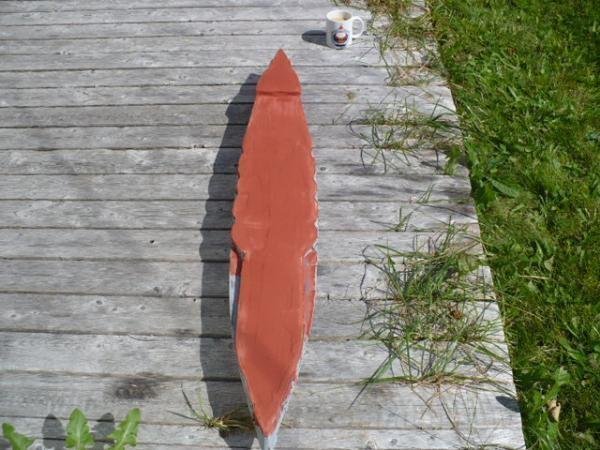

    The main deck has a second coat of resin and the gaps that were not filled from the first coat are now sealed. Perfect. I got most of the dimples out and managed to level out the 2nd coat spread. I hope to get the deck buffed with a light sanding to smooth it out more then I can trace out the deck hathces and barbette mount openings. Once I get this done VDT internals will be installed. After this Bismarck will be worked on.

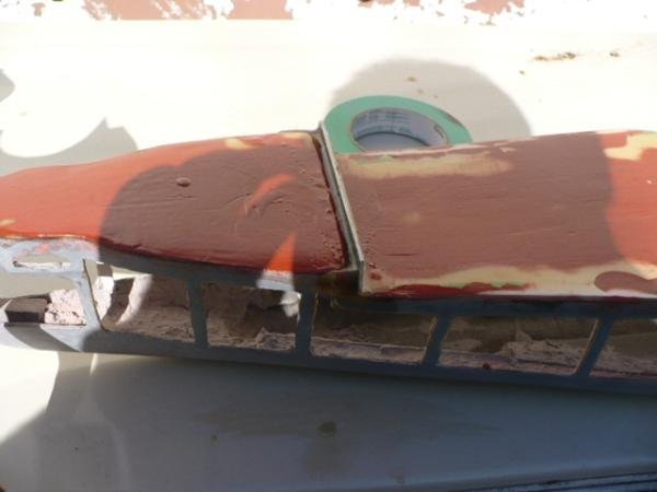

    Sanded and primed the main deck today. Then I resin with a thin coat over the deck. Just needs final sand to smooth it out. The stepped section was finally addressed with a section of sintra going across the stepdown and I sealed the gap between the back side of the Sintra and the hull. Worked out great. Just need to sand it level and flat. Almost ready for the next step. Cutting out hatches and barbette mounts.
  13. CURT

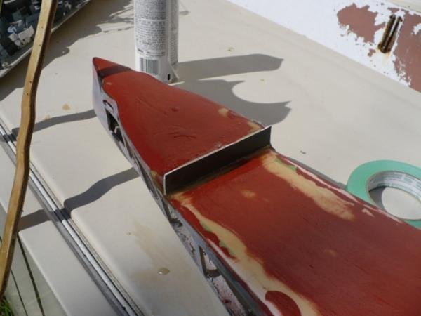

    I sealed the gap of the step down and attached a section of styrene as a bulkhead for the step down.This will be sanded down level to the foredeck and sanded down on the sides to smooth it out.

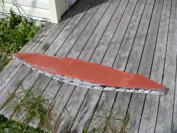

    The sintra deck has the gaps sealed with putty and resin. I layed 2 thin coats of resin over it after the deck was sanded to smoothit out. I then spread a thin layer of putty over the entire topside, sanding it smooth afterward and applied a light coat of resin. Just need to polish it down and smooth it out. Once done I can apply a light coat of primer grey and when dry will begin marking out the hatches and barbettes for cutting.
