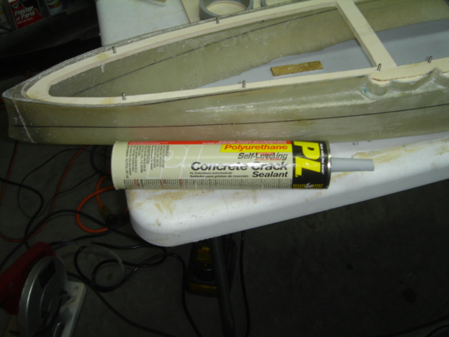

    How hard is it to work with once it is set
    Pretty easy.
    I have widened out the water-channel in my Strasbourg twice.
    Just mark it with a marker, or ink-pen, then slice through it with a hobby knife. Then get under it with a hobby knife that looks like a chisel, and it came right out.
  4. Powder Monkey
    is it strong enough to screw into ?
  5. djranier
    I have all my Team Delta boards mounted to it, using metal screws, been a year now and they have not come out.

    I don't think we have that brand here in Canada. The stuff I used was kinda gritty, not silicone like.What would be the Canadian equivilant?

    I wouldn't screw anything heavy to it. It is rubber.

    If you are looking for light weight, rigidity, self leveling, etc. Smooth-on Feather lite http://www.smooth-on.com/Urethane-Plastic-F/c1120_1162/index.html might be just the ticket for you.
    If you want a slope, just tilt the ship in the direction you want it toi slope up while it cures You want it to slope up toward the bow, raise the stern).
