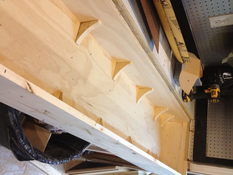

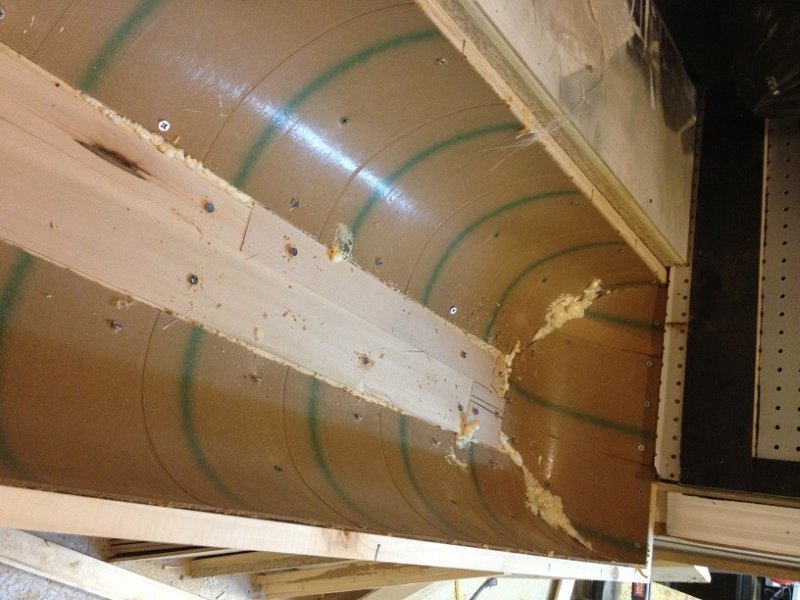

    Change of plans, decided to make a box that will fit a Yamato so the portability of the tank was not feasible. It can still be moved, but as you will see it will take more time than it is worth.
    Decided to cut the tube in fourths so I could get the maximum width. Rebuilt my table so that the box with lid on it will be the original height.

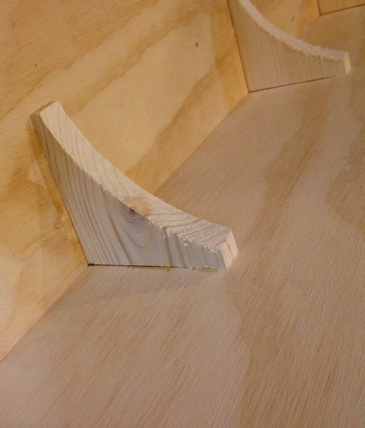

    Made a series of braces to hold the tube, spray foam was used between each brace.
    Overall view of the box prior to installing the tube.
    Tube is installed and you can see the spray foam. Next step is to glass the box.
    I was going to get all excited about it... but BUTT JOINTS!!!???? BUTT JOINTS!!!??!?!?!?!11!!@@$

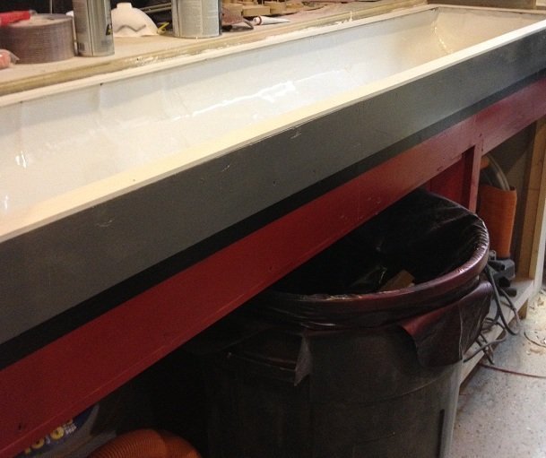

    Water test tank is done except for the drain. Tried to stay with the ship theme when painting, now all I need are draft markings. After rebuilding my workshop table, this tank can be removed and used outside or taken to another house for a build session. This one will fit even the mighty Yamato, so I should be good to go. Now just need to install the top using a piano hinge so I can have a workbench when not water testing.
    What I would do differently: Find a place that has the 16" tubes (local stores only had 12"). I would then glass both sides with 3-4 layers of cloth after cutting it in half. Attach this to a baseboard the same width and use wood supports underneath (like I did) and glass the ends of the tube. This will be lightweight and easy to store.
    After you add it all up, I would suggest going with the bunk feeder if you can transport a 10' container from the store to your house. At 100-150, this is probably the most economical choice, but not custom so you get what you get.
