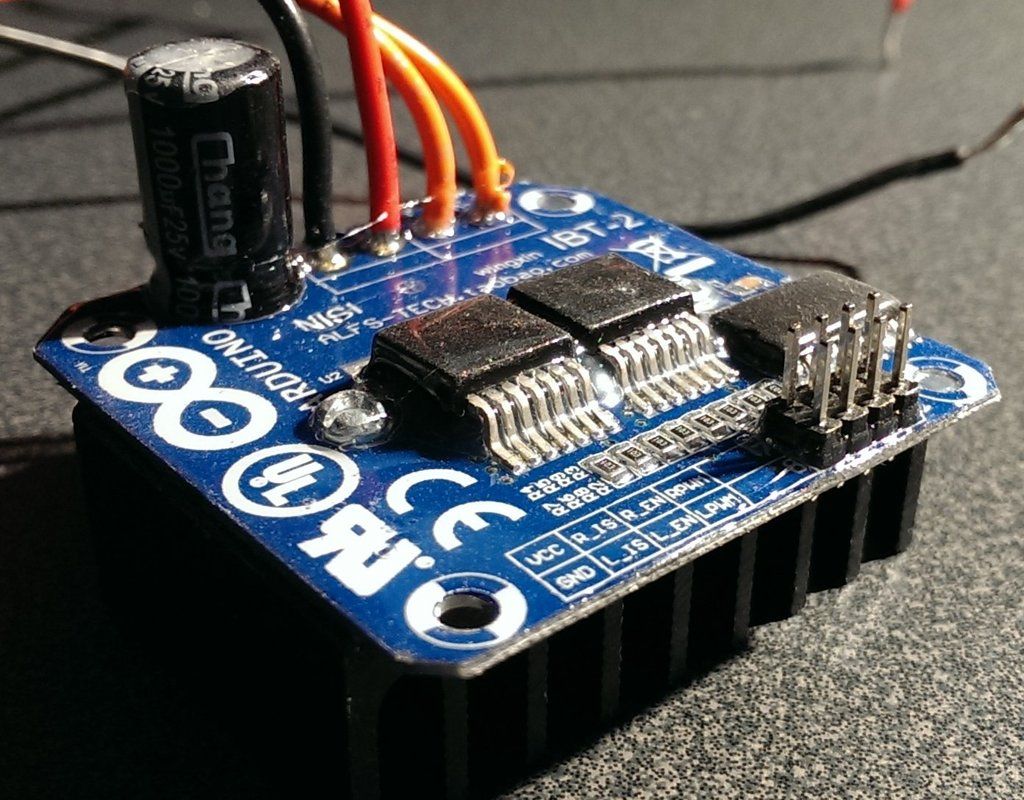

    To add to your confusion even more, another product you can coat electronics with is E600o adhesive. Dries crystal clear and available at most hardware and craft stores.
    Board coated in E6000
