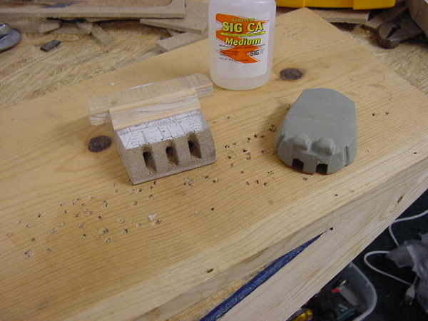

    I've been working on two main projects: 1/144 IJN Hyuga hull plug, and the 1/96 Yamato turret set. At the end of the day yesterday, I had gotten half of the outline of the main cut out. Very time consuming, but it looks cool. On the secondary plug, I drilled out the gunports, and started hollowing out the interior. The turret walls are 1/4" thick, front is some thicker, plus it has the slope of the armor working for it, should be good to go. The tricky part is getting adequate detail around the sighting hoods between the gunports.

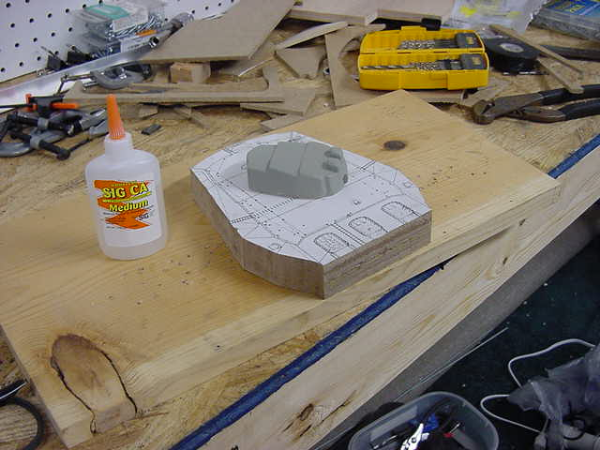

    Okay, it's been a few days since I posted. I've been insulating more of the shop, and I got the hull-work bench done. I'm also getting ready for some minor surgery to rearrange my head (I know, I know, it's needed it), so progress hasn't been stupefyingly fast of late. I _did_ manage to find my digital camera, so I have some pics of the Yamato turrets in progress to share!
    This one is the Yamato main turret plug, with one of Brian K's 1/144 HMS Vanguard main turrets on top of it! Keep in mind that there is still another layer to get laminated on to the Yammer main turret, so it's still a mite shorter than it will be.
    This is the Yamato secondary/Mogami main turret plug next to the same 1/144 scale BB turret. The funky hump with the rangefinder will be cast separately from the body, and then they will be epoxied together. None of the detail is on this one yet, but I thought I'd share.
