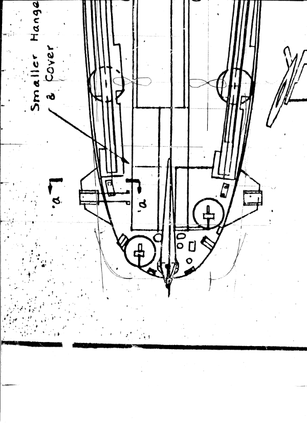

    Here's the corrections that I made to Wiswesser's plan at the stern. My penciled-in changes are the lighter lines. I've also extended rib locations, prop locations, & drawn a center line on the plan view.
    Original plan had the hull with a classic "cruiser" stern, but numerous photos clearly showed a transom. Corrections were based on several good photos, & I felt like I got it pretty close. Adjustments needed to be made to the last 5 (?) ribs, too. I built using 1" spacing, which I'll never do again! Thinking at the time was to try to avoid gashes from oblique-angle shots, but that hasn't ever been a real problem on any other ship I built since. This was my 1st effort, done without any hands-on help (some remote advice only), but I learned a heck of a lot from the experience - especially things NOT to do again (like the 1" rib spacing). Stability was definitely an issue & took a lot of work to get it right (or close enough to it, at least).
    What I'd recommend, for building ANY ship, is to get several different plans, compare each to the other (as well as any photos of the actucal ship(s) that you can find), & make your best "executive decisions" based on what everything shows you. Note that many "original" plans are based on 1 set that somebody else drew, based on the original builder's plans, so some errors may get copied as well. If you can get a copy of those original builder's plans, that's ideal. For USN ships, "Booklet of General Plans" are available from the US Nat'l Archives for just about anything/everything ever built. Working from a different scale is no big deal - after all, that's what the original shipyards did!
