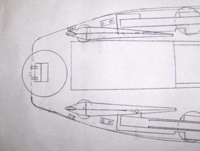

    George (The Plans Master) Goff has the correct Stern (your Penciled one ) also depending on the ship Earlier Versions CA 68 to CA71 had two cranes on the fan tail the Pittsburgh introduced the single air craft handling crane forcing the single twin mount 40mm into two twin mounts on either side stern

    That still doesn't look right to me. Too much inward taper at the sides, starting near the aft-ends of the catapults, with the transom too narrow. Aft-most 40mm mounts are wrong, too. Here are some actual 1:1 photos:

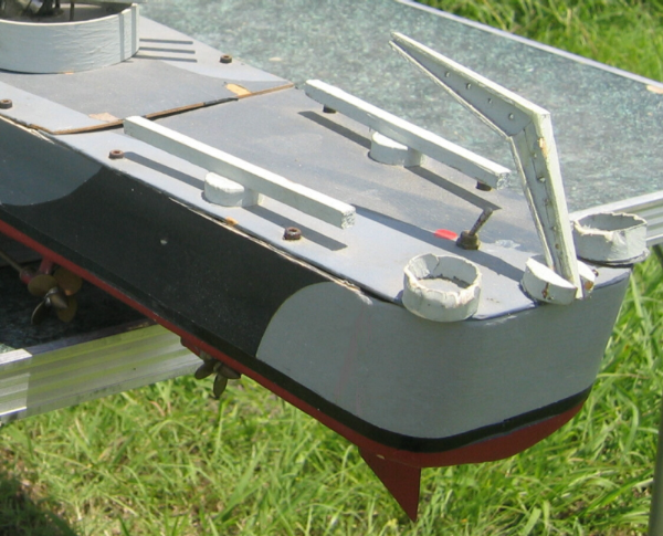

    Here's how mine came out:
    JM
