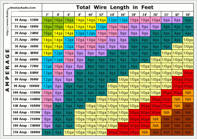

  6. SteveT44
    Lots of sage advice on wire gauge's but here's the chart. This is for 12v. If your running 6v, then multiply the amp draw of your circuit by two and match it up to the amps on this chart for your wire size. If your running 24v, divide the amp draw by two and compare to the chart. If you have a 6v 20A motor, times the 20 by 2 and match the 40 to the 40 on this chart which tells you you need 14ga if your run is under 2' (run is total length of the positive and negative wires between the motor and battery). If you have a 24v 20A motor, dived by 2 and get 10 and you see that 16ga wire is more than adequate for up to a 6' run (gotta love 24v ;)).
  7. djranier
    You could use 22 ga, but I like the 18 just because it feels sturdier.
    What kind of wire is spec'ed on your chart? Says car and audio, most likely not as high quality as noodle wire, less strands.
    Current Capacity (Ampacity) of Silicone Wire
    Silicone insulated wire has a higher temperature rating (usually like 200 degrees C), and consequently it can handle relatively higher currents than a comparable wire with normal (pvc plastic) insulation – of course this doesn’t say anything about what the wire is touching and if it can handle the higher temperature, but anyway.
    You came here to answer the question “I have some silicone wire, how much current can it handle”, here’s a rough rule of thumb
    Take the cross sectional area in mm2, multiply it by 25 and that’s a reasonable current capacity in Amps for SILICONE wire.
    Example: 20 ga wire
    Cross sectional area: 0.5mm2
    Multiply by 25: 12.5
    So that’s about 12.5 Amps, let’s call it 12.
    Our 14 ga silicone wire
    14 ga has a area of 2.08 mm X 25 = 52 amps.
    Looks like on your chart, if you use silicone wire, you can move it down one space, just due to the higher temp rating of the silicone coating.
