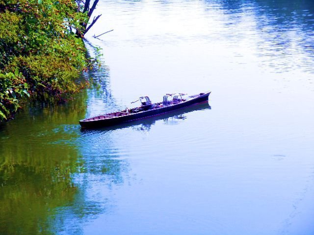

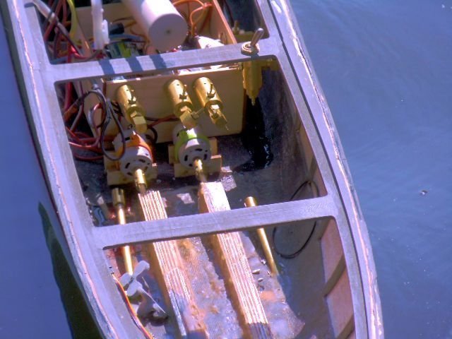

    [​IMG] The initial launch of [​IMG] Wisconsin had its highs and lows. The first attempt had to be cut short because of a massive leak from an improperly sealed starboard skeg. My son and I also noted that the starboard shaft seem to be binding especially when the motor was being run in reverse. When I returned Wisconsin to the MABG Shipyards in Virginia Beach I began the repairs to the skeg. I sealed the skeg with fiberglass resin and waterproof epoxy putty. Additionally during the shipyard period I was cleared the excess solder out of the starboard bushing for the starboard shaft. The prop was able to rotate freely both forward and backwards.
    During today’s refloat, I let Whisky sit in the water for approximately 20 minutes. After the 20 minutes there was a minor leak from the port dummy shaft, but nothing to prevent getting the ship underway. So it was time to take her out for a spin. :D

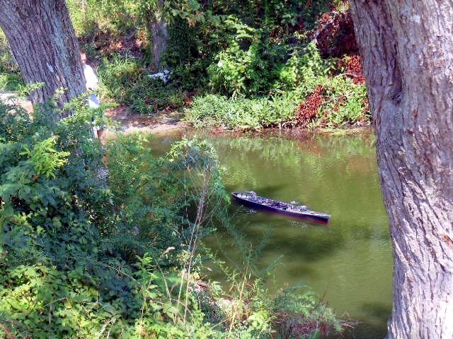

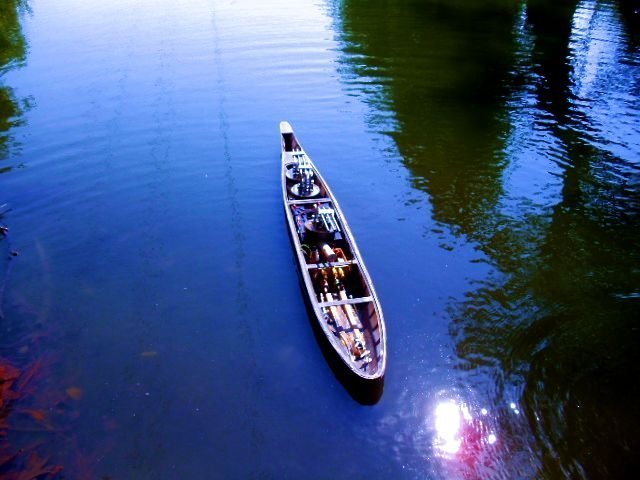

    [​IMG] [​IMG]
    On Wisconsin's initial journey up the inlet and out into the open lake the speed good. She was a bit sluggish when turning to port. Upon further inspection, the rudder was not shifting to port as much as it was to starboard. So when I get her on the bench, I will need to do some further investigating and adjustments to the steering servo.

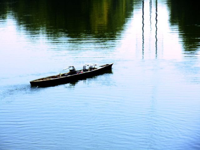

    [​IMG] I ran Whisky on the lake for over an hour with no major incidents. I have a few more minor tweaks and some cosmetic work before Wisconsin is ready for certification. I am sure that she will be ready for the MABG August Event . . .
