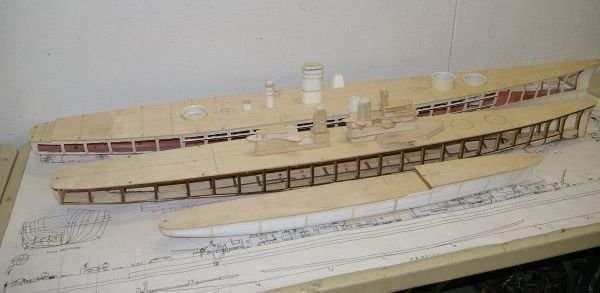

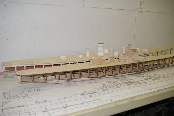

    I just couldn't help myself. I am such a turd.
    My new fiberglass Alaska is in the background.
    The sub-deck is installed, and the deck is in place.
    Windows are cut out, but not cleaned up just yet.
    My stringers for the armor belt are currently too thick, as I have not yet decided
    just how I want to go about layering the belt.
    Phil's new Baltimore (from one of Mark's new wooden kits) is in the middle.
    Phil was able to assemble the kit in a fairly short period of time. It fit together very nicely.
    The rib stations are notched into the sub-deck. So there is no quess-work as to how far apart to space them.
    He is now in the process of wrapping the bottom of the hull.
    A really nice kit indeed.
    My new Le Terrible fiberglass hull is in the foreground.
    The sub-deck is installed, and the decks are in place. Windows are masked off, and ready to cut out.
    Just thought I would add some salt to the wound.
    You can kinda see the 1" below the waterline plate, and the double-keels in the Baltimore.

    Part of it is perspective in the photo, but the Balti looks almost as long as that Alaska!
  18. froggyfrenchman
    Yes
    And it also looks a lot like the Alaska.
    As they used general cruiser theory to build her.

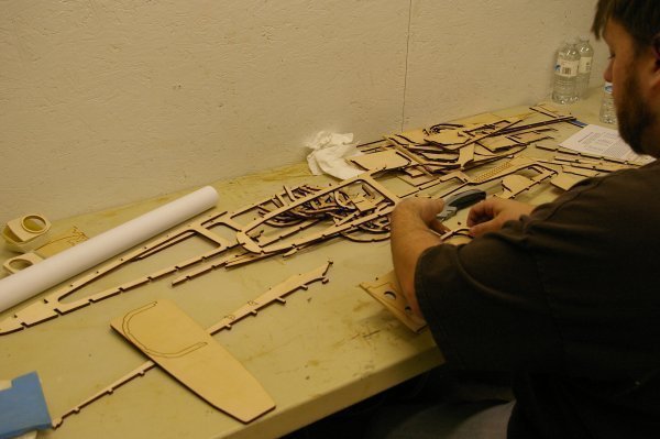

    Stephen starting to work on his brand new Baltimore class cruiser kit that he got from Mark.
