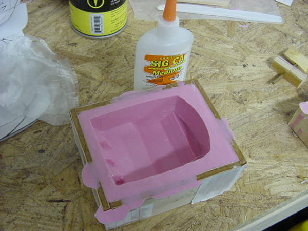

    My craptacular camera just crapped out again. needs a new battery. Suffice to say, the secondary mold is getting poured in a few minutes. Going to cut off the rangefinder hoods, and cast a big mold for the turret, with a smaller one for the rangefinders.

  10. Tugboat
    When I go out to the shop this morning, I hope to find a perfect Yamato secondary turret mold. It pained me greatly to cut off the rangefinder ears that I'd worked so hard to make pretty :( But they'll get their own molds and get mounted to the turret. But having a perfect mold for the big part would make my day. Possibly my week. I'll post an update later today.
  11. Tugboat
    The mold came out great! I'm going out to cast one after lunch, I wish the dang digital camera would play nice.
  12. Tugboat
    Looking at the secondaries mold, and thinking "that'll probably take a pint of urethane all by itself," I decided to mold a turret from fiberglass to see how it would go. It's going very well :) Takes longer, but it'll be lighter for the same strength, with more room inside for guns. So Mark, your first secondary is being made right now :) The wife is working on lawyer-stuff tomorrow, so I'm going to be in the shop working on 1)Finishing the first secondary and 2)getting the secondaries' rangefinder pieces detailed and cast a mold from them. The turrets will be plenty thick, no worries :)
  13. Tugboat

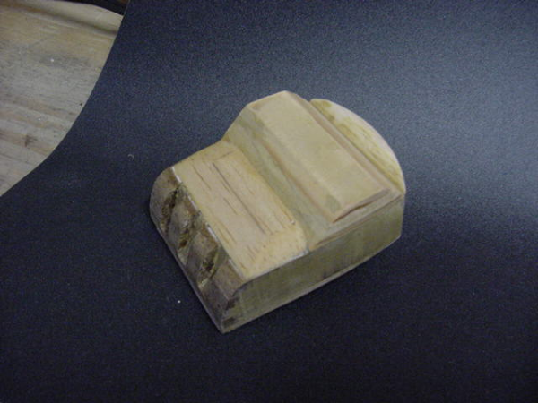

    Okay, the forming of the secondary is well under way, but I got a pic of the mold before I started, and of the plug... Hard to really see the angles and such, but here they are.

    so all the the turrets will be fiberglass? thats fine by me as long as they can take a beating and require little maintenance. how they coming? got the $$$$ waiting to go out. priced out the gas system (not including guns) going to be in the ballpark of $700.00 when all said and done:( good thing I just got a better paying job
  15. Tugboat
    They'll be strong as heck, should be maintenance-free. The secondaries' rangefinder hoods could conceivably get blown off or dinged, on account of the thinness of the material. I think they will be both glued and screwed to stay on. I'll make some extras for you to stick in your parts box just in case. And I'll still have the molds, but I don't think it'll be that big an issue. The delaying issue on the secondaries is getting a low humidity day to work, we got several days of torrential rain and even the AC couldn't get the humidity down enough to do resin work. Icky.
    The mains are a mother to get the angles right. That's the main delay on them, sand sand sand, crap! fill, sand sand sand.
