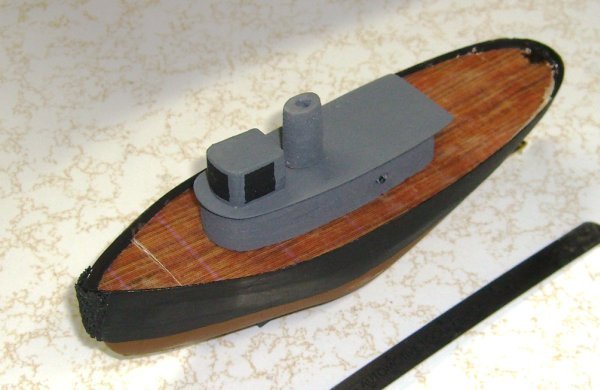

    OK, I know this isn't really a warship because it is unarmed, but I am so pleased how it came out that I wanted to share it.
    I made a 144:1 scale model of YTB-142, the Nokomis, a Woban class district tug. At 100' it comes out to just 8.3 inches long and 3.9 oz total weight. I started with a fiberglass hull and added a small brushless motor, 10 amp speed control, small servo, receiver, and 1/2 oz of ballast. It does float on its scale waterline. I took it out on Sunday and ran it around the pond a little. Anything over about 1/4 throttle just made the prop cavitate, so it was very over-powered. With the way the prop is setup and the large rudder, it will turn 180 degrees in about 2 ship lengths. I hooked up a line to my Roanoke and towed it around. It didn't tow it very fast, but this little 4 oz boat did pull an 11 pound ship. Mikey took some photos, so when he gets them posted I'll add them here.

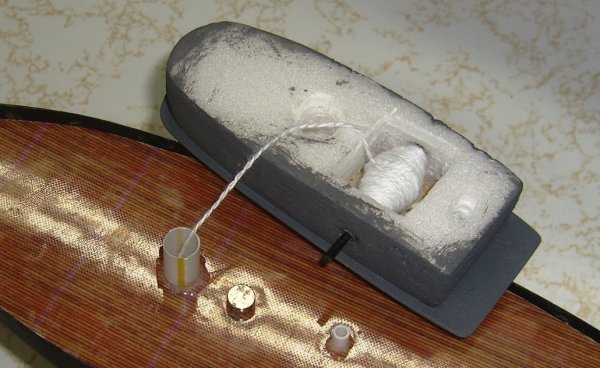

    The entire superstructure acts as a recovery float, with a winch for the line hidden inside the hollowed out back. The deck is held in the center by one super magnet. The straw that holds the superstructure on also doubles as a vent, for when I (hopefully) get the deck sealed.

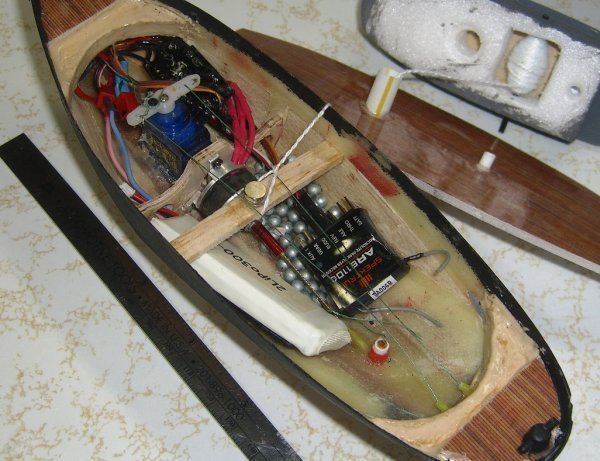

    The inside is tight, but not too bad. I have a two cell 300 mAh LiPo battery to supply the power. Since full throttle is about 0.3 amps, I should be able to run it for an hour or more on one charge. I did cut the windows for the penetrable area (only one 1/4" rib) and covered it with balsa so that I could run it in combat. But after running it around, I changed my mind, since any hit would probably knock it right over. Oh well.

    Very cool little boat. Watch the lith/po as I think that's one of the ones that goes BOOM! More stable than lithum but not stable like lith/fe (iron)
    A... tugboat? Quite naturally, I approve 8D
    Nice packaging job, too!

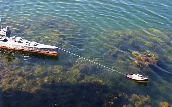

    Here's a picture of the tugboat pulling the Roanoke. It didn't move very fast, in fact it was probably about scale speed.

    question: when you were pulling the Roanoke, were you still able to steer? ie could you pull the Roanoke where you wanted to go even if it wasn't initially facing the right direction?
    Very cool Mark.
  9. rcengr
    I was able to pull the Roanoke in a complete circle, but it was a fairly big circle. Maybe if I had someone on the Roanoke's rudder it would have worked better. At one point I was about 45 degrees off the beam and the tug was just churning water, so making it turn was not easy.
  10. Tugboat
    If you actually want to use it for a tug's design purpose... you want a very large low pitch prop for better thrust at low speed.
  11. Kotori87
    Actually, guys in the WWCC have been trying to create a "ship recovery device" for years, because recovering disabled (but not yet sunk) ships after battle in a timely fashion plays an important part in our regular sorties. After 15 minutes of combat, the CD calls "cease fire", and then everyone has 5 minutes to return to their team's home port. If they don't make it, there's a pretty big point penalty, so we get lots of practice playing bumper boats to get the ones with moss or electrical problems back home. Several guys have actually installed launchable tow cables on their ships to aid in recovery, but in every test the force required to pull a 45lb battleship at even a slow speed is greater than the turning force of the towing ship's rudders, and leaves the would-be rescuer stuck in a straight line.
