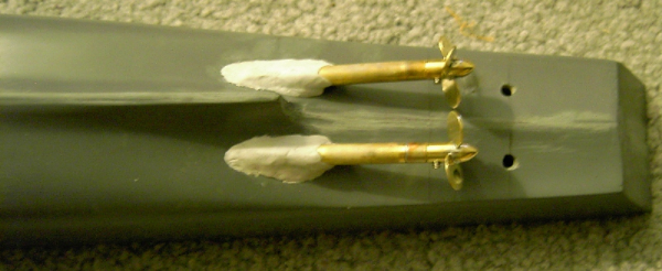

    Here's a photo of the roughly-installed prop shafts/tubes with the drilled holes for the rudders on my Z-25. The tubes are held in place using 5-minute epoxy putty that will need further shaping later.
    The empty hull of the Mogador beside the Z-25. There were some issues with the Mogador so it's being resheeted and the drivetrain is being reinstalled. The Mogador also still needs some of its intermediate ribs installed. While the Mogador is already small, it's quite apparent here that the Z-25 is going to be even more cramped and the build may very well depend very specifically upon the successful implementation of spring-fired torpedos.
