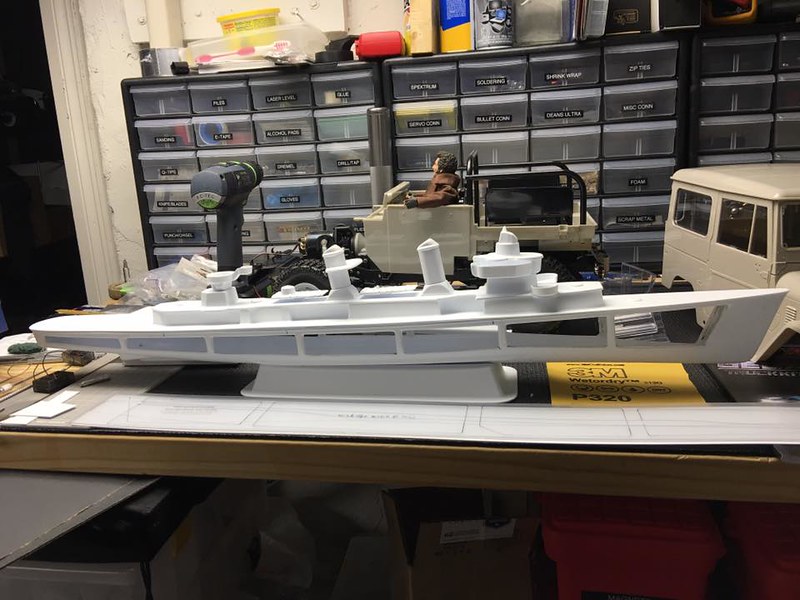

    Got mine to this point last night. Just need to gather up the remaining parts.

    Start a build thread!

    That's the point in at as well going to start my build thread once I get more parts in and an afternoon to work on it and take some pics. The cutting up the hull and superstructure was very easy thus far. Very happy with the quality of the kit thus far.

    It is a very good quality kit. I am generally overly picky in this regard and this kit exceeds the value without a doubt. I've also had excellent customer service from Phil.
