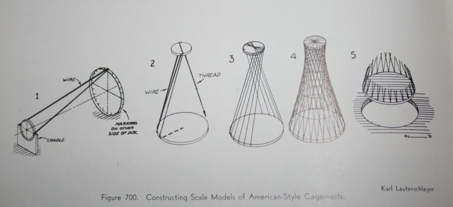

    I saw the articles on making them with wire (either the balsa form or the two discs separated on a wooden dowel the length desired for the height of the tower. One question: to get the form out from inside the soldered wire, does one cut out the bottom of the tower after it is soldered?
    BrianK
  18. Lou
    2,126
    Get a piece of balsa the correct length. Put it on a drill or drillpress and use sandpaper to get the form you are looking for (narrow at top, larger on bottom). Make two disks so they are slightly larger (diameter) than the top and bottom. Decide how many wires will look "correct", and cut the same amount of notches in each one. Attach to top and bottom (dry fit) of the form shape using pegs (small pieces of wood/dowels/whetever). The idea is the first couple of wires will hold the top and bottom on. When you are done with superglue/soldering, cut the wires with a dremel on the bottom/top disk and the form will fall out.
    Make sense?
    Here is the original on this site from a few years ago:
    https://rcwarshipcombat.com/threads/cage-masts.407552/
    In this image you can see the wire still attached to the bottom after being cut:
